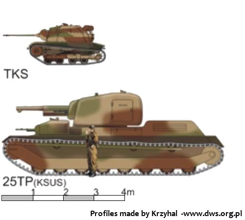

and the best pics-comparison of 25TP tank/ TKS recon tank (tanketee) I know, made by “Krzyhal” from one of Polish forums:
Painful preparations and answering questions with no 100% convincing answer already started  Hopefully some parts of 7TP tank looks similar and I`ll use them after necessary “facelifting”
Strange thing is, that tracks are quite narrow - only +/0 30 cm (1:1). It means same as in Vickers/7TP, light tanks family … Looks like our engineers took to optimistic view when planning this tank. Well, experience comes same as love, after some time
Seriously speaking I really doubt in those speed 945/25 km/h). Right now I`m making “mother-wheels” ( those bigger ones) to copy. I need 32 of them so it will take some time.
