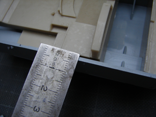

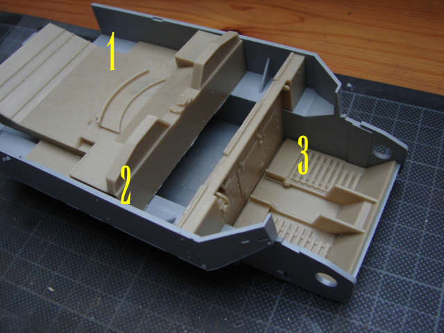

The dry-fit of the Verlinden interior.
1) Verlinden provides no info on where to glue the floor. The only help you get is from the packshot but it's too tiny to see the position. I'm also not sure if there was no anti-skid plates at all on the floor of the fighting compartment, I can hardly believe this. If anybody has info on that, let me please know.
2) Poor fit, later more on that.
3) Driver's and radio operator's compartment are not too bad.
The interior is about 1,5mm short both sides. That's a real let-down. As I got to know recently, this "new" Verlinden kit for the DML Elefant / Ferdinand is just the old one for the Italeri model, relabeled. Thank God Italeri's attempt was not too bad. But it's a bad idea by Verlinden to do so and even charge 52€ for it - they just lost themselves a customer. The interior also seems to be simplified.

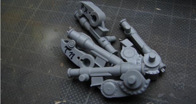

Okay, upper pic. Don't know what went wrong here, but the inner toothed ring is mating part B14. It's not unmovable, though, bit I just want to know what's wrong here. Do you have an idea? It looks not wrong to the instructions...

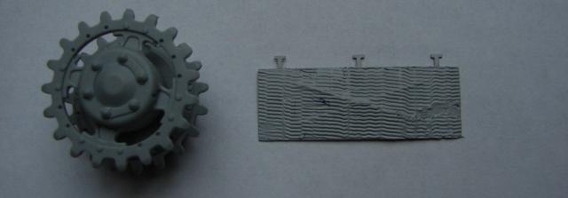

Here's a very little update.
I put on a little Zimmerit on the tool box. I'll stick with the acrylic putty, I decided now. Although it looses structure and looks better when still a little wet, the primer (Tamiya Surfacer Super Fine Light Grey spray can) shows that it's good. With all the paint it will even look better.
I should have pressed the "X" in before I added the Zimmerit because the tool box cover has now a light bulge which can't be treated without destryoing the Zim, but it's not too bad because it's not a big one and the box will be open. So it does not need to line up with the actual box.
The sprocket is just to show you guys how big or small the Zimmerit stripes are.
Johannes

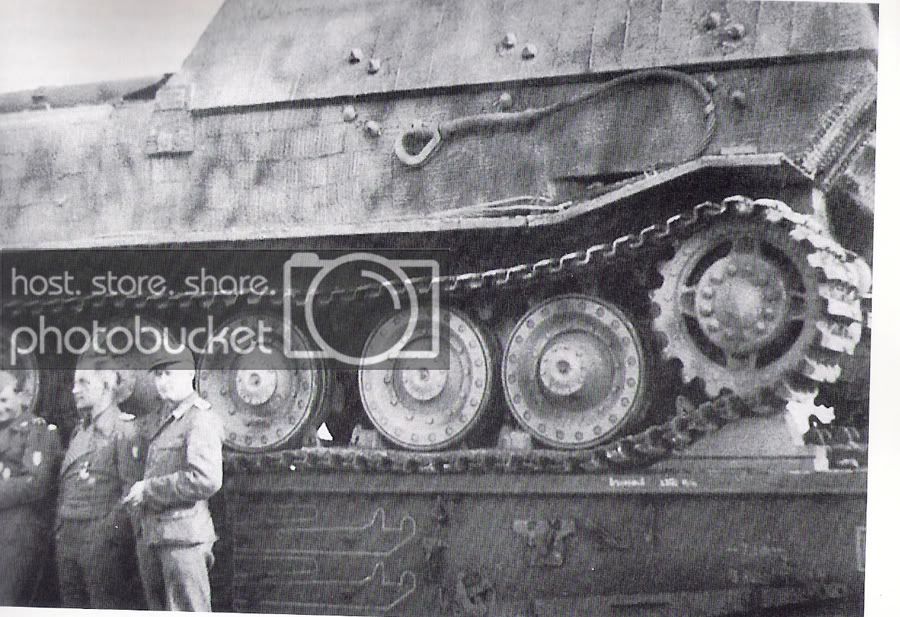

Here I have some photos from the Excellent Spielberger book Heavy Jagpanzer and also from Wydawnictwo Militaria Ferdinand/Elefant.
This is another photo of the tow cable Rubber sleeve
