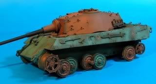

I started with a COMPLETED TAMIYA King Tiger that needed paint but already had the detailing done for a Jan/Feb issue tank [Aber brass, VP resin engine bay and all the scratch mods done]. This tank has some slight shelf damage so I thought it would be ideal for this project as some of the tank will be covered with debri - good for hiding missing and broken parts. This will need a little work but would allow me to get away from the detailing for a while.....
I base coated it with Tamiya black then gave it a ruff , light overspray with Tamiya RED Brown. Please excuse the photo's here as the lights were too bright and took out my color and contrast to a certain extent.
I next added a more definate coat of Pollyscale Panzer RED Brown - but still patchy.
I had to remove the wheels for re-painting as well as to fit on the dio base. These had to be broken - off because they had been glued earlier. They will be OK as there will be a lot of debri covering a lot of the bits and pieces as it is gong to be sitting next to a building.

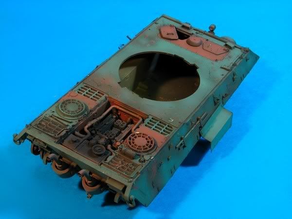

I made some of the sections of the hull more intense in color so that they would look as though they had been replaced/ retro fitted............. I made these red brown as though they would have come from earlier stock that had not beeen used yet.
Next I added the maskol to cover the red brown areas I wanted left sharp then oversprayed with Tamiya black green. I applied this coat in an uneven way to simulate a hastily done dark background base.
The Primer look has nicely offset the green and has come out just how I wanted.
Next up was the ghost coat with Testors Panzer Olive green to give it that worn and faided start to the detailing stage.
