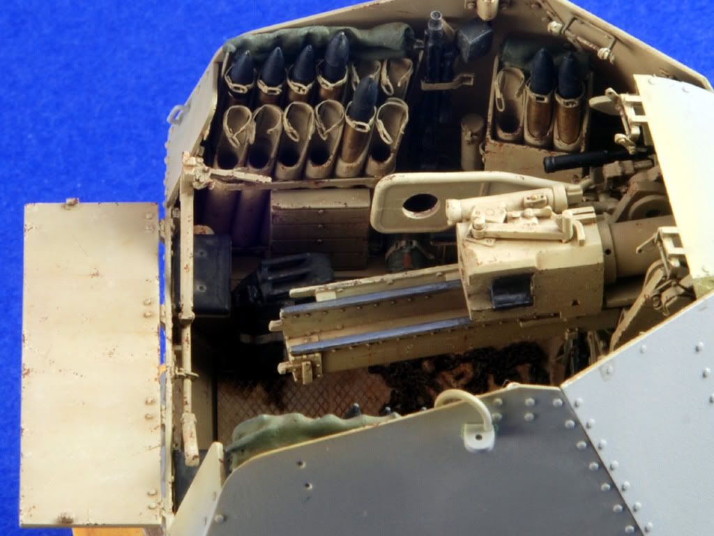

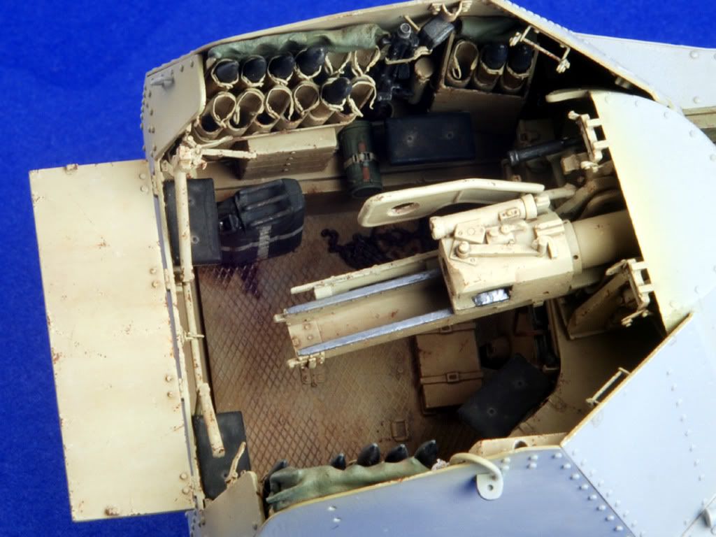

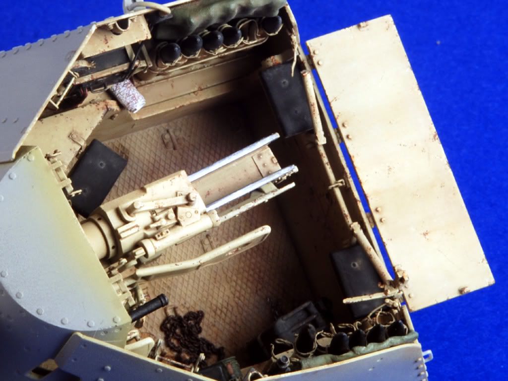

some real progress has been made......
Finally got in a groove and accomplished some major things on this build. First, and the most obvious, I've gotten the fighting compartment put together. This had made it especially difficult to photograph but I've attached several from different angles to try and get in most areas but it's just really hard to do...... Anyway, here goes...... Before I assembled everything, I have the breach parts and the "slides" a coating of humbrol metalcoat shiny steel and buffed that up to a pretty good shine. Can't see yourself in it but in scale it's not half bad.
I did a few more washes, added some oil stains here with the Mig stuff especially on the guns moving parts and thern off course pigments and some graphite on the floor where I had previously drybrushed (again, hard to see).
The water jug is a verlinden item that I had. Painted in panzer gray with the white cross. I took the liberty of spilling some on the floor for effect. Again, hard to see.
There is also a chain and towing clevis stuck up in there as well but I didn't really get a good shot of it.

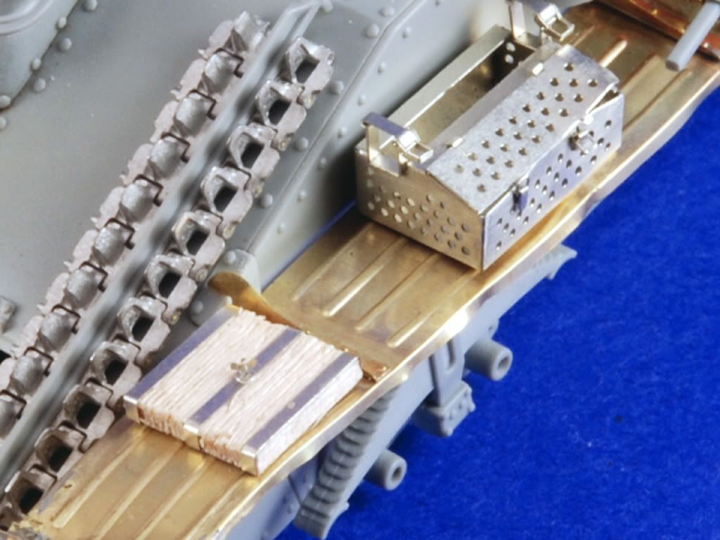

Now, on the the hard parts..... I'm not the best with the soldering gun but I'm "ok" with it but these fenders were really a pain. The rear brackets were easy. I did this with the torch as I find that much easier and cleaner. Simple put a layer of solder on the bottom of the part and coat it with flux, hold it tight with the pliers in place and hit it with the torch. It melts the solder and sticks it in place with no visible solder to clean up. The front was done the same way but took several efforts to get right and in between each I had to wick out the old solder and clean up everything. The problem was that you can't really hold it in place like you need to and the joints on the fender sides like to come apart if you heat it for too long. Finally got the right balance of heat and it took. I went ahead and applied some solder the normal way on the front ones so they'd hold up with the bending. No use in using brass fenders without bending them all up afterwards So, here's what I got. Left the right side relatively unscaved but worded over the other side pretty good. Had several reference pics of these to go by and they were often in pretty bad shape.
The jack block was made with pop sticks. The thickness was pretty close to the kit part and I just had to cut them to size and put the seem under the center strap. Much easier to replicate wood with the real thing than with hard plastic.

Looking good so far! Neat weathering on interior, I like it!
