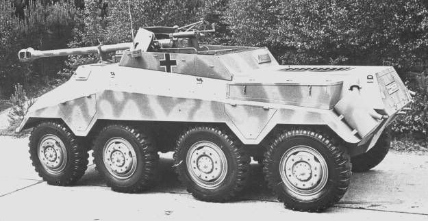

Well FJ, you made me go over some of my references with a magnifying glass and I noticed that you are right so I will redo the rear armor plate. (Can you send me a photo where I can see the hinges?) I was using this photo as a reference in which you can see the rear visor in the plate.
But now that you mention it I think that this is the Munster's vehicle.

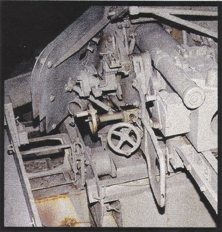

About the radio and the box I don't know what you mean by wrong. (Position, orientation, style? In the posted photo the radio is not glued yet.) But I can show you my reference.
This is a photo of the 234/4 at the Patton Museum. Sorry about the quality but this is a scan of a page I printed long ago. Here you can see the radio arrangement.
