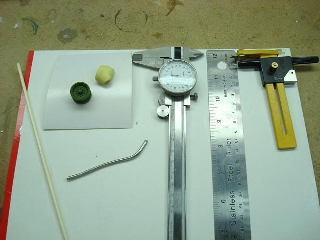

good morning gents! today i want to show you a little trick to mask the wheels of the AFV´s
all you need its this:
TOOLS:
vernier caliper
ruler
olfa circle cutter
blue tac or similar
silly putty
airbrush
MATERIALS:
styrene sheet
wide soldering wire
bamboo stick
first with the vernier, measure the wide of wheel

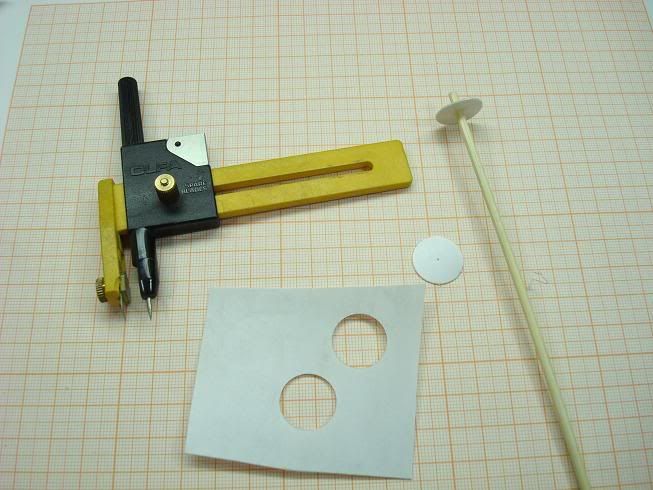

then when you have the right wide measure of the wheel, use the ruler to open the olfa circle cutter to an a proper size, cut two circles and then glue one to the bamboo stick

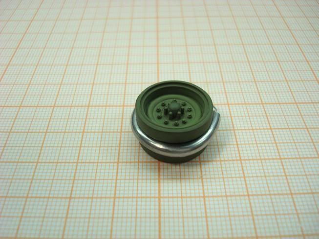

use the soldering wire and wrap it around the wheel
put a bit f blue tac on each side of the styrene circle

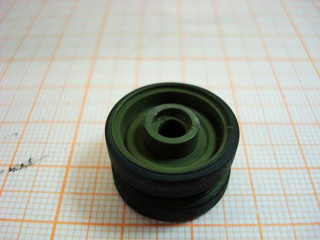

with your airbrush spray matt black or gray paint to the wheel
voila!!!perfectly painted wheel! check how in the middle of the wheel still have the original NATO green
